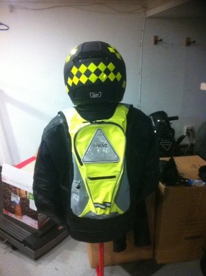

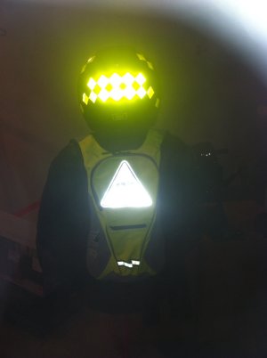

I looked for a while at swapping in an NT650 single sided swingarm. But I wanted to get the bike running first, so maybe that's a future mod.
Helmet got some amazing hi viz reflective treatment from 3M and I also picked up a hi viz backpack. Dark bike, dark helmet/leathers = not too bright in more ways than one.
