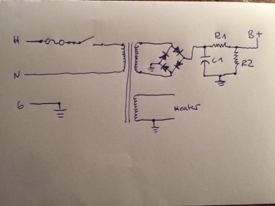

So that was the point I missed. I read that there does not need to be an (audio-) input signal present and therefore completely forgot about the B+.
That means the solution would be one heater circuit with 6,3 volts AC  (max. 3 amps) and one B+ circuit with 130 volts DC.
Basically a reduced version of the Crack PS (see attachment).
Is the filter stage with R1 and C1 needed for this purpose?

Reply #4 on: January 09, 2015, 08:05:11 AM
Orson,
Depending on whether or not you have extra 220uF caps you might want a CRC filter with the bleeder after the second cap.
As for cold heater inrush, all heater transformer makers know that there is a cold inrush.  They design for it.

Reply #5 on: January 09, 2015, 08:08:07 AM
You could just leave each tube in your Crack running overnight.
Otherwise, your power supply will give the necessary voltages to cook in a 6080.

Reply #7 on: January 09, 2015, 10:02:13 AM
Yeah, you are right. I burn in the tubes over night. At first I was a bit afraid of running the Crack alone but having it on the last days for 10 hours proved that it runs stable at a constant temperature.
The circuit needed is nearly half the Crack. That makes only sense if one has the parts needed in his drawer.
But thanks for sharing your thoughts.

    • Posts: 5822
Reply #10 on: January 09, 2015, 04:05:12 PM
Thanks for the fast replies.
Don't forget to have a cathode resistor! The point is to have a substantial bot controlled current through the tube. No filter would be needed.
