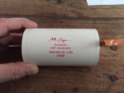

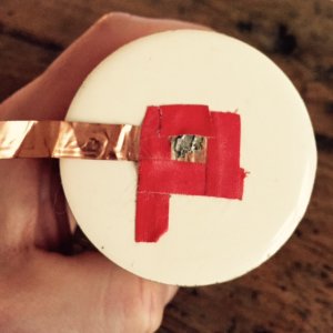

I managed to get a nice and huge cap for replacing the third cap in the power supply.
It was cheap because one leg is broken and substituted with copper foil. I will redo the solder joint, does not look good to me.

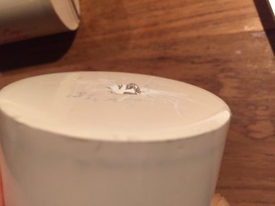

I disassembled the copper foil - no luck. The remaining leg is about 1mm. No chance to make a solid mechanical connection.

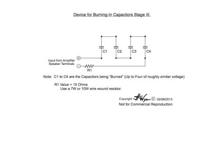

Now with the new cap I don't want to break them in with the Crack but before assembling to instantly evaluate the possible change instead of waiting 100 hours not knowing how it sounded before. I found here some posts of Grainger linking to a fast break in for caps. Unfortunately these links are broken. Has anybody a working link to that topic at hand?
The only circuit of breaking in caps I found until now is the one attached.

If you take a sharp knife to the end of the cap and carefully pare away the resin around the stub of the lead out you might be surprised how much lead out can be revealed you don't need much more to accomplish the docs J method

JamieMcC - neat trick. Thanks.
Indeed I could create a nice hook that can provide a stable connection.

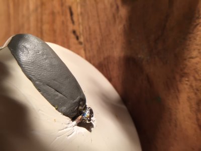

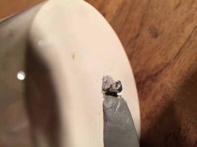

I was able to make a good solid connection between the short and the new lead.
They grey stuff is dough glue for car repair - very hard and can take high temperature.
Soldering was not easy with my 40W-iron.
Could definitely look better bit I think it could do the job.
