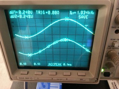

My Extended FPIII is oscillating in both channels (scope trace hopefully attached to this post).  The oscillation took out the left channel of my power amp awhile back, so I started to investigate and tore apart the Foreplay and replaced the shunt reg board and C4S boards.  Boards have all new parts and also updated to MJ5731AG.  Boards were charred and black at B-I and B-O on both left and right C4S boards.  Shunt board was discolored too, but no charring.  Voltages all check out after the rebuild.  Resistance at 12 and 21 are the only thing with some deviation (around 60K instead of 83K).

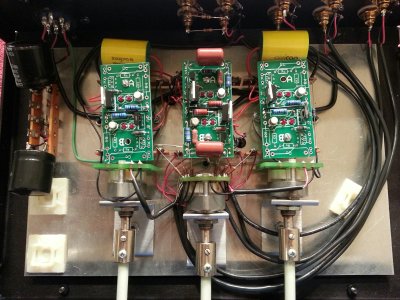

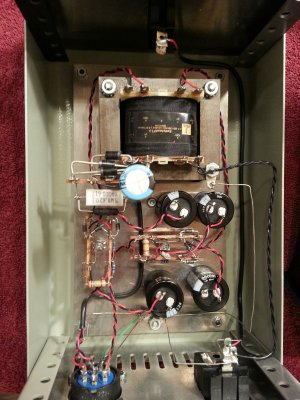

Thank you Doc...double checked the power supply capacitors are all correctly oriented.  The caps are brand new Panasonic and were replaced when I re-did the PC boards.  Attached are a couple of photos of my build.  Power supply is separate and runs through a 3-ft long shielded umbilical.  There is also an earth ground wire in the umbilical that connects the two chassis's.  All power supply voltages are within tolerance.

That's a pretty different configuration than the stock kit, which makes it rather difficult for us to troubleshoot. The oscillation could be layout related, from capacitance in the umbilical cable or some kind of ground loop. You might want to disconnect the supply from the preamp circuit and see if the supply oscillates by itself.
