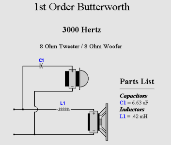

Does anyone have the Straight 8 crossover V1 schematic.
I have a 0.68 foil inductor  and a 3.3uf capacitor.
If not -  How would I wire these up.
+ve terminal to 0.68uf inductor - to woofers?
+ve terminal to 3.3uf capacitors to tweeters?
All help welcome -   otherwise I may have to start singing.

Here is a screenshot from lalena.com, it is a basic first order crossover.   Hopefully this will help.
Dave

Thank you Dave
That is exactly what I need.
