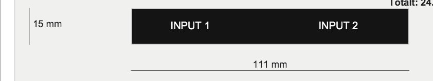

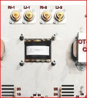

I believe the inputs are mixed up on page 23.
Viewed from atop, the left inputs are 1, the right inputs are 2, I believe.
For most not such a big deal, but I wanted to make a make a plate similar to the

It's just that I want to add the following plate under the inputs, and it does matter that the markings aren't the wrong way around.

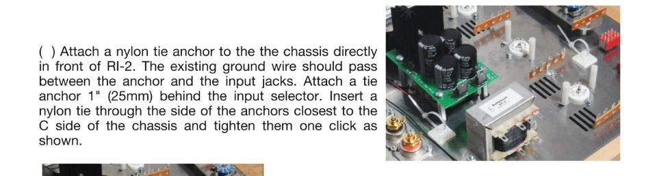

I am saying the diagram on page 23 must be wrong, the text should be swapped like indicated on this illustration.
Edit: On all following pictures input 1 is referred to as input 2. I added a screenshot to illustrate:
« Last Edit: January 28, 2015, 09:56:24 PM by Strikkflypilot »

Reply #8 on: January 28, 2015, 09:35:05 PM
Please look at my edit and the attachment. Maybe I have missed something...

Reply #10 on: January 29, 2015, 06:47:55 AM
I am following what Geir is saying here. The terminal identification page labels the jacks differently from how they are called out in the manual. Since it is consistent in the manual, it ends up working for any builder that looks at the pictures as they build (I would estimate that to be the vast majority of builders (and, for that matter, most builders seem to not label their terminals (which is my pet theory as to why no one has brought this up before))). It will be fixed in the next version of the manual and continuing to fuss about it is not a great use of anyone's time.

Reply #12 on: January 29, 2015, 07:21:09 AM
No worries. I figured it out as soon as I looked at the manual. I still have no idea how I managed to screw that one up. When we make the manuals, we have a hand written terminal ID page that we refer to as we make the manual. Somehow I flubbed it on the way to the final version. It'll be an easy fix (aka the kinds of fixes I like...), so I do appreciate you letting us know about it.
