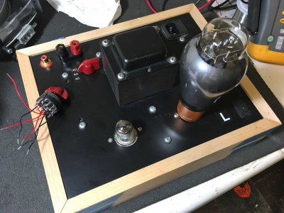

Offline kip.duff
    • Posts: 89
Reply #9 on: November 02, 2017, 12:17:54 PM
This worked out really well but took me a while to figure out schematic and placement to keep things neet.  I hope to post some photos and the schematic should anyone else want to try it.
Dr. Feickert Blackbird II w Reed 2A tonearm and Lyra Skala cartridge.  Eros 2.  Audio Note DAC 2.1 Signature.  BeePre with BeeQuiet and Paramount 1.1 monoblocs into A7 VOTTs or Nagoaka folded horns.
Offline kip.duff
    • Posts: 89
Reply #10 on: November 15, 2017, 05:59:02 AM
I installed the speaker impedance switch that Paul Birkeland recommended in this thread because I have speakers with differing impedances.  Took a while to figure correct location and schematic.  I'm attaching a picture of the finished install and a PDF I made giving details and pictures of the install.
