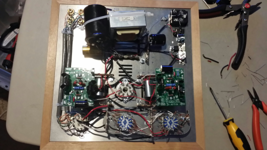

Reply #3 on: March 30, 2015, 08:09:01 PM
Smash is all complete, Smash up and Smash quiet installed.  Think I'm done with this one...
One error in the instructions:  on page 16, last step.  Writing has you connect to the fine switch while the picture connects to the coarse switch.  I followed the picture.
