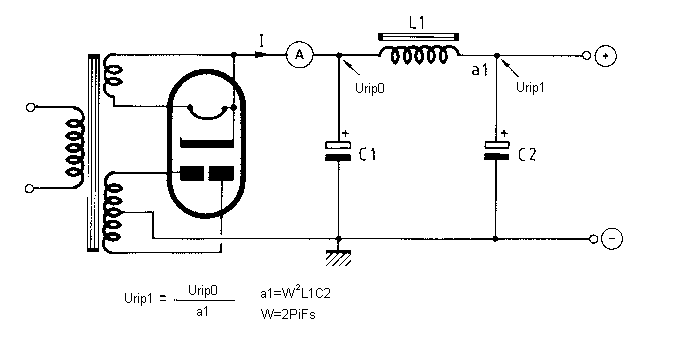

I must have not had my wheaties for breakfast  that day...  A fullwave voltage doubler, just by definition, would have to be a capacitor-input filter.   Otherwise it wouldn't really be a voltage doubler   I was stuck in the center-tapped HV secondary / 5AR4 rut that day ;-)
(https://forum.bottlehead.com/proxy.php?request=http%3A%2F%2Fwww.bonavolta.ch%2Fhobby%2Fimages%2Faudio%2Fsupply03.gif&hash=1cd30063f14fbe47c1ee3491838921f3c50e83c3)
As my bud Homer S.  sez, D'Oh!!!!   0_o
/ed B (in the  state of confustication)

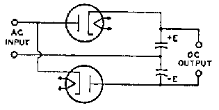

As far as  full wave voltage doublers, I was thinking of this basic circuit, just replace the tube rect's with SS rectifiers (as done in the SEX amp and others).  It can be fed with a non-centertapped power trannie. With no load, it will deliver approximately 2.8X the AC RMS input voltage, as the current  load increases, the DC voltage output will decrease.
(https://forum.bottlehead.com/proxy.php?request=http%3A%2F%2Fwww.bonavolta.ch%2Fhobby%2Fimages%2Faudio%2Fvdbl.gif&hash=5b68c6543774b3f205c37fe5f7b48a06648cf6cd)
Since its output has two caps in series, it would be, by default, the first part of a capacitor input filter...
/ed B
