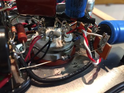

Reply #9 on: March 07, 2015, 04:20:15 AM
Hard to see in the pic, but on terminal A5 there is a resistor lead sticking up in the air towards the capacitor, just check that isn't shorting and ship the end off to be sure.
