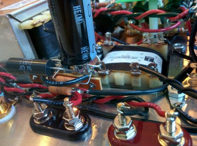

Offline boulos
    • Posts: 126
Reply #14 on: April 17, 2015, 11:19:52 AM
Thanks Paul!  So adding the resistors prevents the heater from drifting away from ground, thus avoiding the fluctuation and hum?
Here's a picture of the two resistors installed.
