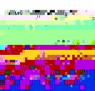

The Schurter 1A power entry module with line filter has approximately 30dB of attenuation at 50khHz for common modulation [and nearly 0dB for differential]. That's not bad. In addition to that it keeps all the RF crap out that might cause trouble.
The reason why I don't always use them is that they are really best at keeping noise from inside the device away from the line [the Crack isn't causing any as far as I can tell], plus there is a potential for ground loops when these filters live in more than one device, plus Doc's proposal to use some X2 caps etc is more flexible and effective.
Schurter filter graph attached, solid line is common, dotted is differential:
