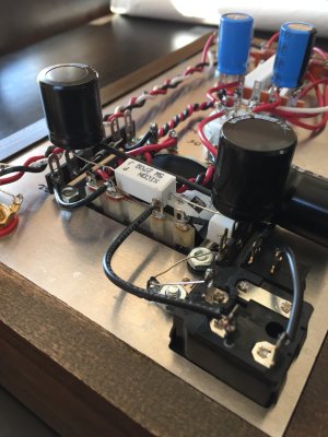

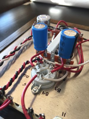

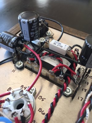

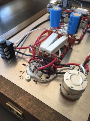

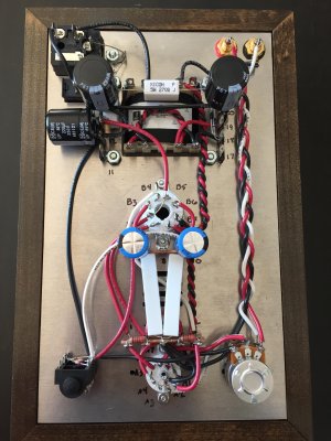

Can you post pictures? You have terminals that should connected by a simple piece of wire that are reading differently.

I added pictures to my first post.  My build looks identical to the one in the manual as far as I can tell.  I triple checked each step and used Cardas Quad Eutectic solder throughout if it matters.  Hopefully I'm just missing something simple.

B3 is connected to 7 by a piece of wire.  This will give them the same resistance readings.  Can you recheck?  B6 is connected to 9 by a piece of wire, so the same logic follows.  In your photos, these wires are present, so one must assume that there's a measuring issue.  6 and 10 go to ground through the 2.49K resistors at the headphone jack.  I can see in your photos that they are there.
Which terminal were you using for ground with your measurements?
