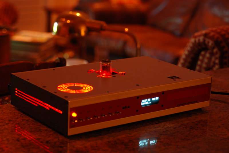

Build your own....
(https://forum.bottlehead.com/proxy.php?request=http%3A%2F%2Fimg442.imageshack.us%2Fimg442%2F3733%2Fdsc0182po.jpg&hash=9accb6ae2e556ea9bf5d01bcd1ee254bc24cbc53)

    • Posts: 19744
Reply #5 on: June 13, 2010, 07:43:24 AM
I wish!  Essentially, it is one of the many available CD-Rom controller boards that makes the whole thing work nicely.  I produced a giant PC board that makes +5, +6.3, +12, +125V all regulated to run the CD drive, its controller board, the DAC, and the tube buffer.  Total parts cost for this guy was around $1500.
When Doc is done with his DAC project, I may revisit this piece and consider a revamp.  For now, it uses a DAC from Scott Nixon.
