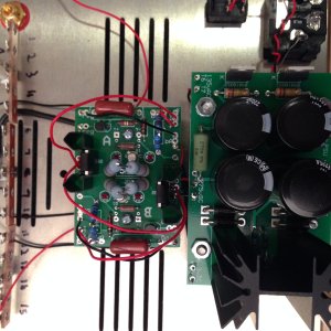

What do you see on each Kreg?  Can you post some photos of the board and its connections?

Reply #3 on: June 14, 2015, 03:15:24 AM
Pic

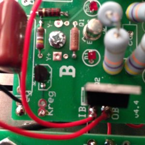

Reply #13 on: June 15, 2015, 12:11:45 PM
Paul I have checked every single part on the shunt regulator board and confirmed them all.
Also went over the wiring for every tube pin on D socket.
I am attaching a closer pic of IB and I0.......could a solder bridge cause the voltage drop problem?

    • Posts: 20257
Reply #14 on: June 15, 2015, 01:54:18 PM
I don't see a solder bridge between IB and OB, so no issues there.
Can you snap some photos of the bottom of the board?
Also, can you carefully measure the voltage on each side of the 2.49K resistor on the offending side?
