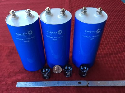

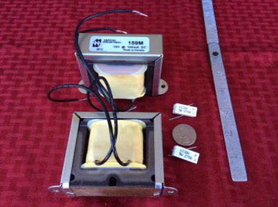

Jamie, I saw that post when I was scouring the Internet for any info on the
Khozmos.   I think I forfeited the Crack chassis when I purchased these for the power supply.  :)
Warning! Capacitor Porn and choke porn ahead.

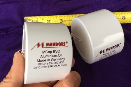

Grabbed two of these for the output caps a few months back when HiFi collective had them at an excellent price.   MCap EVO Aluminum Oil.     Porn is porn.   :)
