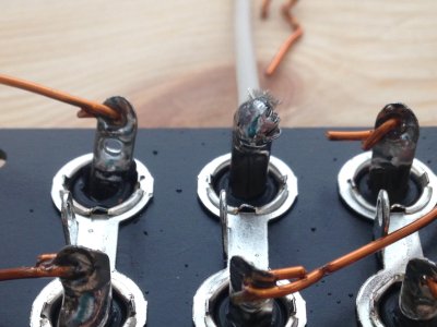

I thought I would use single stranded wire of similar gauge to practice on but all they had was copper wire.  My results trying to solder this to the terminals was very poor.  Could not get the solder to stick to wire at all, in fact it seemed to repel it and just run off and go anywhere but on the wire.  I was really starting to doubt my ability at this point.
Just to experiment I got some other wire I had in the house which was some stranded wire, but silver, and tried that, and it worked like a charm first time and it was easy to load on as much or as little solder as I wanted.  Joint seemed nice and secure and shiny.
Was I doing anything wrong or is it just that its a different type of wire?
Pic attached below - showing the difference, with the successful silver stranded wire joint in the middle.

The copper wire looks to be the type used for coils or transformers. As such it has an insulating coating. This is resistant to solder, hence your problem. As a test you can scrape or abrade off some of the coating and then see if it will take solder.

Deluk - THANKS!
I did as you suggested and was able to scrape some of it off and it was much improved.  Ugh.  Rookie mistake!  The only way is up now.

That enamel coating is a pain to work with, you can either scrape it off, or burn it off.  Sometimes you can just dip the end of the wire into a hot molten pool of solder and it will burn the coating off.
Also the wire and terminals you are soldering onto will absorb a lot of heat so try bumping the temperature up to 400c. Profile 4 assuming your soldering iron is setup with default values ;)

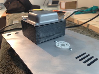

One other thing I need to check before I go any further is when fitting the transformer I noticed that it had some excess varnish/glue around the sides.  I didn't feel like removing them completely but just to tidy up I very gently sanded them flat.  Having read a couple of threads now I'm wondering if that was a bad thing I did - I didn't go crazy with the sanding, just enough to flatten the varnish runs but there were places where the sanding also touched the stacks.  I'm not worried about applying any kind of paint finish if I don't need to.  Pic attached.
Thanks for patience with all the questions.  New HD650s arriving later today :)
Jeb.
