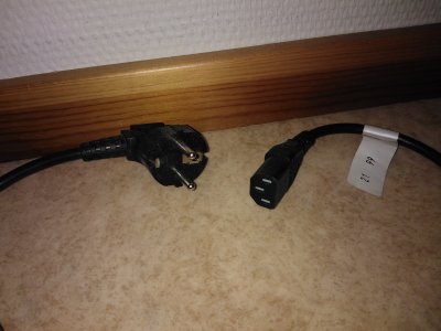

Also, there was no power cord with the kit. I'm wondering if any power cord that fit the plug will work?
I have this cord from an old crt computer screen that seems to fit. It reads 10/16A 250V.

The kit will come with a power cord, unless you're outside of the US (we can't stock every possible power cord for every country), but you've nailed it and scrounged up the appropriate cable!
