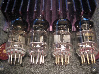

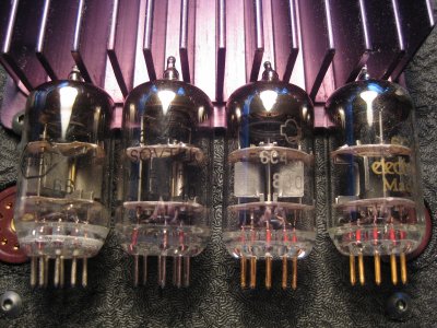

I found a bit more information on the 6S15P tubes.  They were manufactured in Friazino from 1959-1969 which is an interesting little town as it was home to a couple of different Institutes of technology and did a lot of development work for the military.  The tubes were later discontinued and replaced with the 6S45P which was supposed to be cheaper to manufacture.  Interesting feature of the 6S15P is the use of gold grids, and fact the mica spacers, getters, and glass are all subtly different is what made me curious as to who manufactured them.
For comparison i have included a couple of pictures along side a Sovtek, Reflector, and ElectroHarmonix 6S45P.   The EH and Sovtek are obviously the same tube, however the EH versions test better and are also perfectly matched so its safe to conclude they are just cherry picked examples.  The pair i have came in Woo Audio box's so its possible Woo did the matching.  Its also worth noting of the two sets of 6S15P's i have all four measure almost identically, vs the 45's which tend to be all over the place.

Those things look like they were built for soviet tanks. Very heavy duty construction.
    • Posts: 9658
Reply #12 on: February 09, 2016, 04:47:05 AM
Actually I think they were built for Soviet aircraft radar, but not sure.
Reply #13 on: February 10, 2016, 02:00:19 PM
The 6C45PI is an update to the 6S15P, and uses a platinum grid to further suppress secondary emissions, and it would seem to be a hair more expensive to manufacture.
