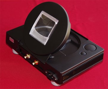

Thanks for that.. Yeah years ago, I believe it was stereophile? who actually went a little nuts with its lofty praise of the first edition playstation... I have heard a $5,000 "Dynastation" it was called that used the basic optical guts and dac chip in the playstation but with a tubed power supply and output stage ( I believe).. In fact, at canuck audio mart, there is a dynastation for sale for 2K with the following description...
 "Anyone who has listened to the DynaStation I and has heard its ability
to outperform $15,000 reference players could never imagine improvement
would be possible. Well it is and the Dynastation II is the proof.
The rare NOS-tubes of the legendary R-Series from Telefunken catapult
the sound of the DynaStation into never before reached spheres.
The proven 32bit DSP of the DynaStation II guarantees the highest
computing power for the D/A-conversion.
The utimate union of the best of the old with the best of the new into
a timeless piece that spans the generations.
