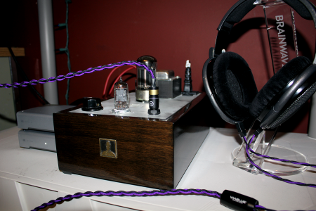

Offline Strikkflypilot
    • Posts: 459
  • Shellac fiddler
Reply #7 on: November 27, 2015, 11:58:25 AM
Love Your base.
What did You use?

Offline Rhok
    • Posts: 50
Reply #9 on: November 27, 2015, 07:54:09 PM
Strikkflypilot:
Minwax 13407 Pre-Stain Wood Conditioner (as directed)
Minwax 22718 Wood Finish Interior Wood Stain, Ebony (1 coat, maximum suggested stain time)
Minwax 60900 Wipe-On Poly Polyurethane Finish Clear Gloss (3 coats, wet sanding with 800 grit between coats)
