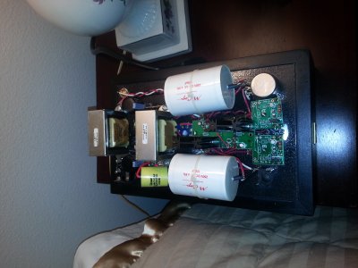

I think it might be possible to fit two Triad C-7x chokes under the Crack chassis. One would be located in the back of the Crack where a lot of builders put it. The other one could be mounted on nylon standoffs above (as seen when the Crack is turned upside-down) the headphone jack. This way, both chokes would be turned 90º relative to each other. You would only have to twist the chokes wires together and solder them at the proper terminals. And then, you have to run a wire from the choke's case to the safety ground tab near the power entry module.
Perhaps that would be locating it too close to the small tube and it could interfere with it, I do not know.
(Standoffs here if you have problems finding some: http://www.ebay.ca/itm/10x-Nylon-Standoff-Spacer-M4-Female-x-M4-Female-25mm-/251232421895?hash=item3a7e9e8807:g:ElgAAMXQySpRJPOH
This seller has screws too.)
Bypassing the last capacitor in the power supply with a good film cap made a noticeable difference at a smaller cost than that of a 220uf 250 volt cap if you really run out of space.
Here is a photo of my Crack with a few changes, notably the addition of a choke and two large film output capacitors so you get an idea of how much room is left.

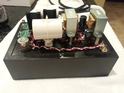

I installed 2 chokes in my Crack. It was tight, but fit.

It did not cause noise in the circuit and do not think that there was a sonic benefit. The one choke and especially the film bypass cap on the last electrolytic improved the sound IMO.
