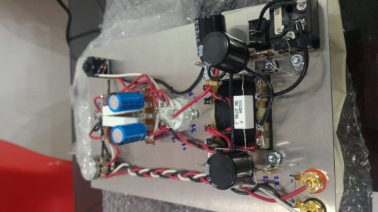

I ordered 220VAC Power Transformer as I am in Malaysia.
I have completed soldering the parts.
I did my checks on the resistors and the values are pretty close. The 0's read as 0.

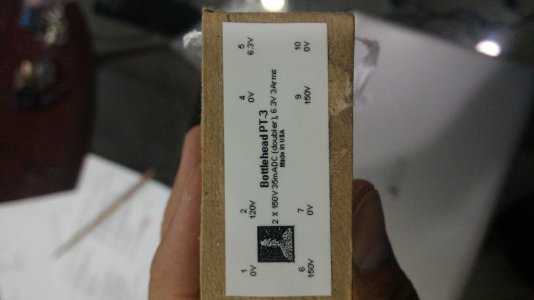

If its any help, the label on the transformer read: 2 x 150v 35m ADC transformer (doubler), 6.3v 3arms
Then, when I went on the do the voltage check, the fuse bew twice on me. Pls troubleshoot for me. And also what value for replacement fuse should I get. Could it be that the value for the fuse is  110v as opposed to the 220 that I need?
Thanks for your help.

Is the transformer labeled 240?
Is this a stock Crack, or is the Speedball installed?
The provided fuse is a 1A 250V fast blow. Slow or fast is fine. The same fuses are sent worldwide. You said you blew two fuses, so what did you get for a replacement?
Can you post pictures of your build?

I dont see any 240 on the transformer.

That's a 120V label. Presumably it is a 120V transformer. When was this kit ordered? By whom?
