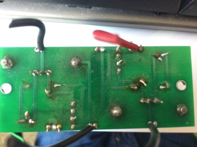

I messed up my install of the speedball, I have some waxy resin substance that is covering the connections of the board making a bridge (not sure if its conductive it came out of the soldier). I also am not sure if I installed the LED's right since I didn't install them upside down. Also I need more wire for the install. It was difficult before because my soldering iron was bad, now I have a good one.
What do you guys suggest I do?

Looks like the center leg of the upper 2N2222A might need a touchup with the new iron. The flux residue doesn't look like anything to worry about. Touch up that transistor leg and anything else that might look shaky and try it again. If that doesn't work you might need to get those LEDs out and see which way they are facing.

The "waxy resin substance" is flux. It is non conductive. But if you want to clean it off, a little isopropyl alcohol, a q-tip and a bit of light scrubbing usually does the trick.
