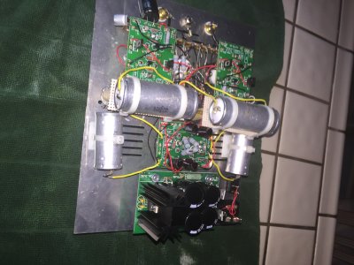

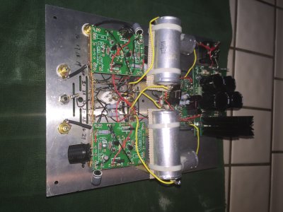

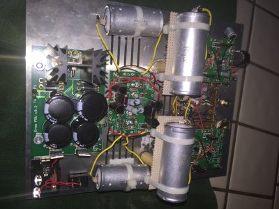

I decided to update my Eros with Teflon (FT3) Russian  Capacitors.  I bought a couple of .22 uf 600V and 1.0 uf 600 V FT3's from a gentleman in Bulgaria.
It took me about  2 hours to do the mod and check voltages.  Everything looked good so I plugged it in to listen.  Well, right out of the gate the sound was definitely changed.  My impression is a much smoother more detailed sound.  The sound stage is deeper and not as forward as the stock caps.  Plus, the instruments/singers seemed to be more concisely placed in the sound stage.  Now that I made the change I think i understand the term smeared.  Also, the old caps did not focus the placement of where the music was coming from in the sound stage as well as the Russian Caps.  Even though I only used 1 (per side) .22 uf to replace the 1.0 uf Solen Cap I did not notice any change in bass.  If anything it is now much tighter and  more concise.
All in all, I am extemely happy with these caps. The sound is just much smoother and more musical.  I have listened to them for about 3 hours now and am hearing things I never heard before.  I would recommend this mod to anyone.
Does anyone know the breakin time for these capacitors. I attached photos of the mods I hope they can be viewed.  These are really large capacitors and it took some thinking to squeeze them in.

You get a gold star for putting the capacitors with conductive cases onto non conducting perf board.  Bravo!

Thanks for the compliment I did read somewhere that these might be conductive so I figured just for safety sake keep them away from metal.
