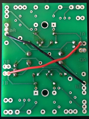

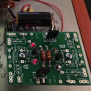

Next I got to soldering and installing the two C4S circuits. At first all four LEDs on both the channel A and B C4S's did not light up. I started troubleshooting by first re-soldering only the joints that are part of the main circuit. This fixed the channel B C4S board as all four LEDs on that now light up. However, on the channel A C4S only the inner two LEDs light up. So I disconnected it from the main circuit, re-soldered all the connections, and then re-attached it to the main circuit board. Still only the two inner LEDs light up (I attached a photo of the channel A C4S).
Any ideas what my next step should be to troubleshoot, or what might be causing just the outer two LEDs to remain off?

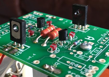

Both LED's on the socket light up. However, unlike the socket on the channel that's working where both LED's illuminate at the same time, the socket LED closest to 8 takes about 5 seconds longer than the LED by 4 before it gradually reaches the same brightness. Would this indicate anything specific that could be going wrong?
I checked for a shorts and there are none that I can see. I attached tope and bottom images of the PCB for reference.
