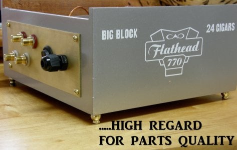

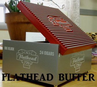

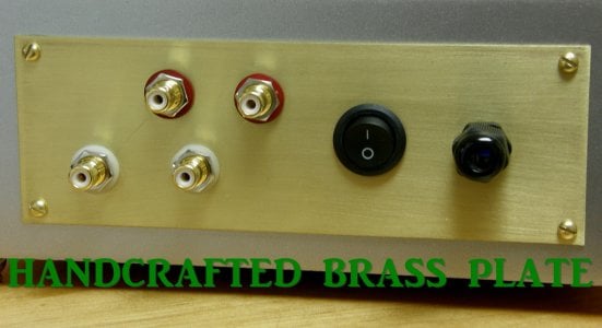

  Here is a shot of the nearly completed project:
