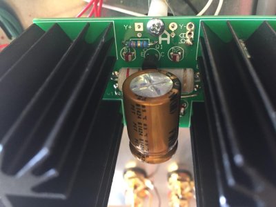

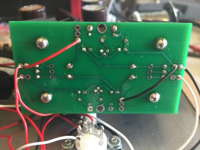

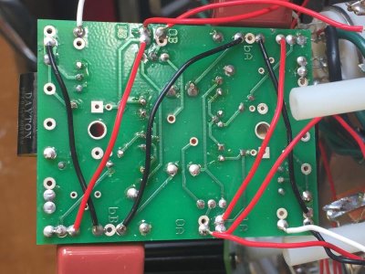

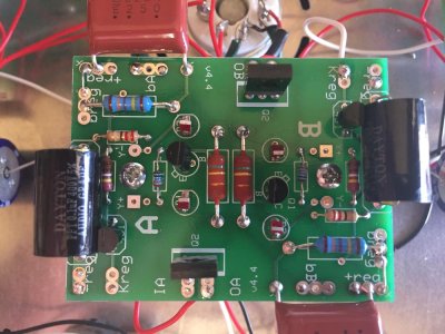

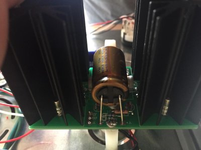

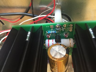

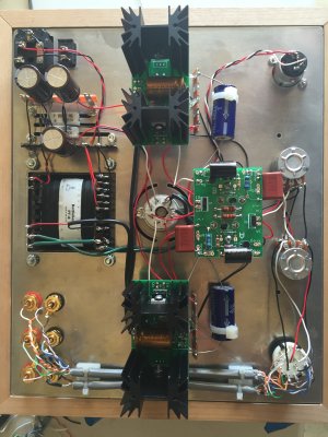

Can you post some pictures of your build? Especially the top and bottom of the boards.

Sorry for the delay in uploading my photos. Thank you for your help.

Reply #3 on: June 14, 2016, 07:13:17 AM
High Current-B Socket:
OB  1.539V
This is the problem that's most likely causing all others.  Seeing 1.5V there could be due to not having the correct transistors installed on your board high current board, solder bridges on the pads, improper jumper wiring, etc.
