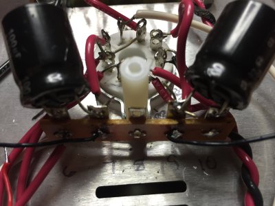

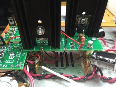

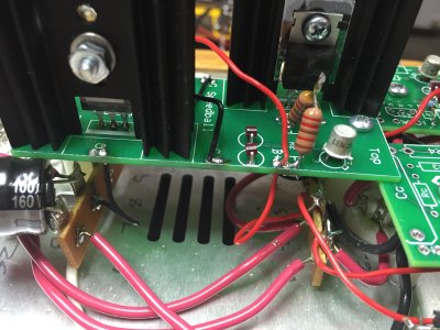

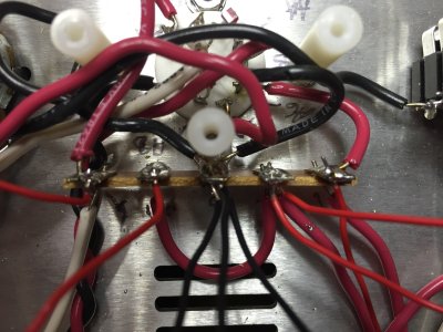

Greetings again and thanks in advance.  I have been using my Crack HA for the past two years and finally decided to add the Speedball.  It has worked perfectly until now.  After I installed the Speedball the numbers didn't match the voltages so I rechecked that I placed all the wires correctly and resoldered them to be sure.  Both tubes light up (the 6030 is well lit, the 12AU7 barely glows but gets warm). I replaced the 1 Amp fuse.  Now I don't have any correct numbers!

Offline fullheadofnothing
    • Posts: 1487
Reply #2 on: July 20, 2016, 04:55:36 PM
Post pictures.

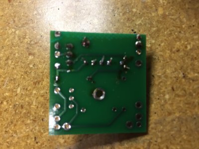

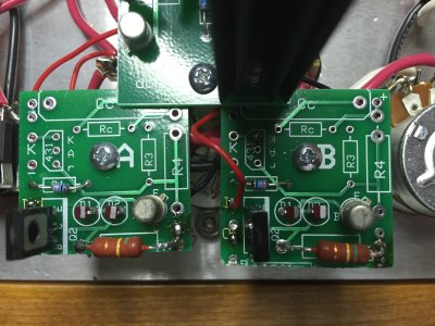

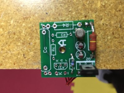

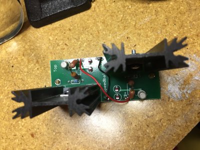

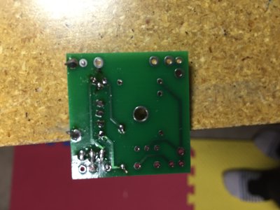

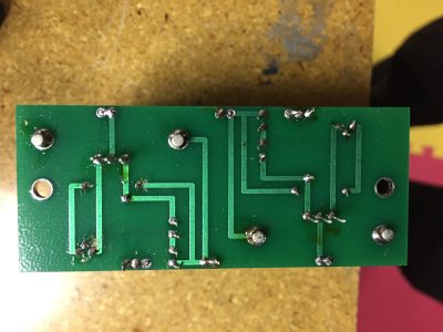

Offline musiciseverything
    • Posts: 54
Reply #4 on: July 23, 2016, 06:36:37 AM
Photos here.  THanks.
    • Posts: 54
Reply #5 on: July 23, 2016, 07:04:00 AM
Lo and behold.  I rewired all of the speedball and many of the previous Crack soldered joints and now it works as designed.  Sorry to trouble you.  TG
    • Posts: 20297
Reply #6 on: July 24, 2016, 05:33:19 AM
Generally your issue would come from not mounting the TIP50 transistors properly.
