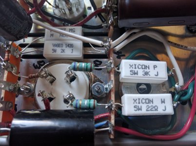

A fresh look at it again this morning reveals that I stupidly reversed the 3KΩ 5W wirewound resistor with the 22Ω 5W wirewound resistor on the D side.
Can anyone provide any tips on how to get this done? Would you desolder anything else other then the two resistors in question? Looks like it could be difficult. Once again, I am a novice. Thank you in advance.
-Ohan Markarian

Those resistors are not expensive or hard to find. I bet BH replacement parts could hook you up.
I would just clip them out, gets them out of the way and you just have the small bit of leed to get free, a much easier task.
Then start fresh with new ones and pretend it never happened 8)...John

Thanks John. That is what I assumed. I clipped them both out right at the resistor leaving some lead still attached to the terminals.
Is it permissible to wrap the new leads around the existing and solder them together rather than de-soldering at the terminal?

Just twist the leads into a tight mechanical connection before soldering. Remember solder is not glue used to tie two pieces of wire together, rather it protects a good mechanical connection from movement and oxidation.  Also be sure to clip the ends close to prevent potential shorting.
