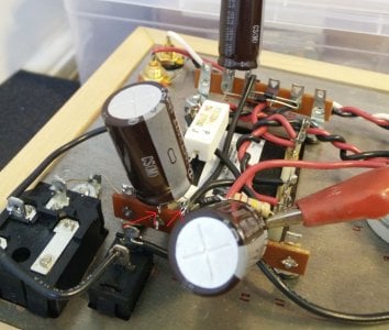

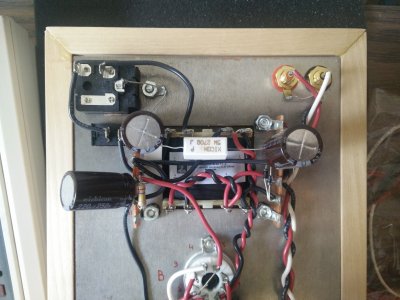

Offline mipheres
    • Posts: 18
Reply #8 on: August 20, 2016, 10:21:23 PM
@fullheadofnothing
I moved the CAP to 14-15, see picture
@Caucasian Blackplate
the resistor seems connected ok , 15-21
the result is the same.
Can the 270Ohm capacitor be damaged?
Thanks guys...
    • Posts: 20262
Reply #9 on: August 24, 2016, 05:56:07 AM
The capacitor that you had improperly mounted may well be quite damaged.
You can remove it from the amplifier, then retest your voltages.  If the cap is the only issue, the amplifier will function properly but be too noisy to use (just replace the 220uf/250V cap with a new one if this is the case).

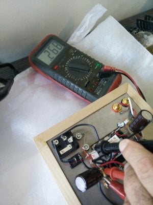

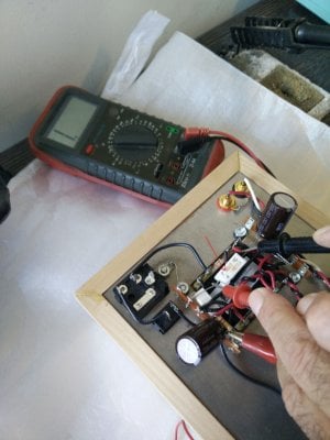

Offline mipheres
    • Posts: 18
Reply #10 on: August 24, 2016, 09:59:54 PM
removed the suspected capacitor, same result.
measured the 270ohm resistor (15-21) and it looks off (see picture attached)
measuring the other 270ohm provided good result, also the 3k capacitor works ok.
I can remove the suspected resistor and measure it without other parts attached , if suggested.
Thanks.
    • Posts: 20262
Reply #11 on: August 26, 2016, 06:48:59 AM
Yeah, that resistor has opened up, most likely due to the placement of that 220uF capacitor.  Both the capacitor and that resistor need to be replaced before performing any additional tests.
You will also want to carefully use a piece of insulated wire to short the leads on each side of that defective resistor for a while to bleed off any residual high voltage.

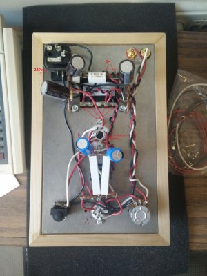

Offline mipheres
    • Posts: 18
Reply #14 on: September 28, 2016, 08:25:45 PM
Hi.
Got and installed new 250ohm resistor with 220uf capacitor.
started the voltage test and got OFF reading on first check.
Terminal_1 is reading 140V instead of
Also 3k-Ohm resistor is running very hot , so I switched off.
Did not continue testing the rest.
what do you suggest to do next ?
