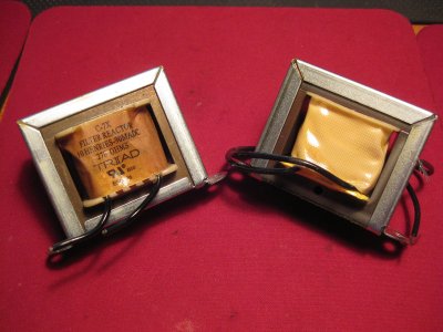

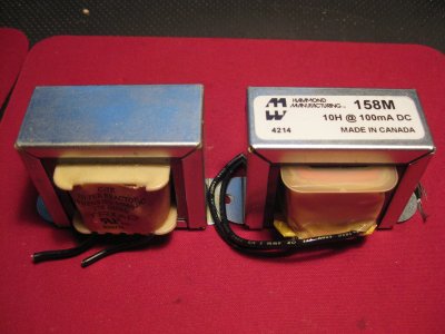

If using a choke is there a difference that should be noted that would determine which to use?
Triad C-7x vs. Hammond 158M.
Triad 90 DC m/a, 10 H, 270 ohm
Hammond 100 DC m/a, 10 H, 262 ohm
Hammonds are almost twice the price.

In my limited experience, neither transformer measures anywhere close to the listed value in resistance. I've both and the build quality or at least finishing is better for the Hammonds.  I noticed no difference when used as intended.
Offline Chris65
    • Posts: 341
Reply #2 on: August 17, 2016, 12:29:03 PM
Triad is made in China, Hammond in Canada, which probably accounts for the price difference.
I also echo Aaron's comments.

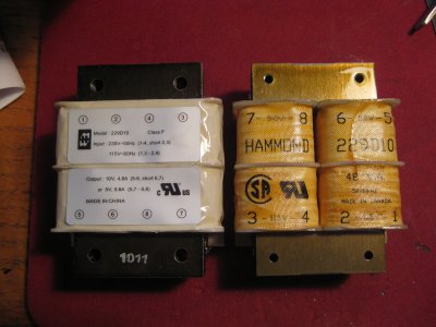

I found the same as Johnsonad says when i had them side by side.  They are probably all made in China anyhow, as i found when i recently ordered a second Hammond power transformer.

Hammond source some small power transformers from China (like yours), but as far as I'm aware all Audio transformers/chokes are still made in Canada.

I have not bought a C7-X in a long time, but they have been built in several places over the years. When the Paramour first came out, they were built in Mexico and done the old-fashioned way, layer wound with paper between each layer - this reduces the stray capacitance, improving high frequency performance as a plate choke. At some point they switched to regular bobbins, and (IIRC) later they were clearly made by Hammond without attribution.
The C7-X comes up often, because it is widely available. But since the layer winding was abandoned, I know of no special reason to stick with it over others with similar specs.

Hah my pessimistic prediction was true, they are made in China now  ::)
Here are the two i have in stock,  Hammond 11.9H 192r, Triad 14.2H 244r
