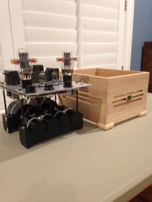

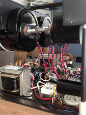

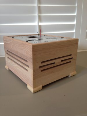

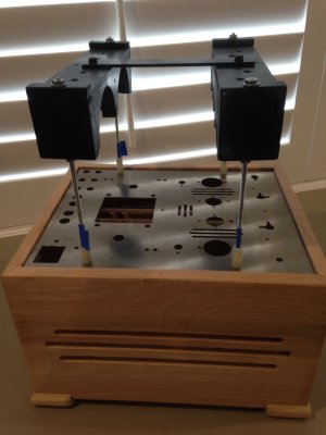

I'm building my second S II, this time with film caps in the PS. Since the films are so much larger than electrolytics, I had to build a taller base which took much longer than I had hoped.Then I built cradles for the caps which I suspended from the chassis using all-thread and nylon standoffs. As the amp nears completion I will need to connect the caps to the terminals with leads that will be about 4.5 inches long.So, my question is, should I twist the leads of each cap before connecting to the terminal or just run them directly to the terminal ( or does it matter)? I'll try to attach photos.

Yes, I would recommend twisting the wires together. The objective is to minimize the loop area, so that local magnetic fields (from the power transformer mainly) do not induce hum currents. Twisting also reverses the direction of sensitivity with each turn, cancelling out much of the residual pickup.

Fancy mounting brackets, how did you make them?

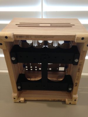

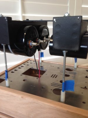

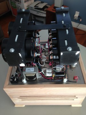

Hi Mark. This is the reason I haven't finished my F4. I'll be getting back to you for some more advice when I pick that up again. The cradles for the caps are made from 3/4 inch pine. I started by routing holes that are the same as the diameter of the caps. Then I cut those in half creating the cradles. Those half pieces are then placed back to back with about 1 inch of space between them and screwed down to a piece of 1/8 inch aluminum that has holes in it to allow zip ties to pass through it to hold the  individual caps. Some end pieces of the same 3/4 inch pine completes the cradle.They hang from the chassis on All-Thread, washers and nuts. I sprayed them with rubber paint (Plastidip). It's all gotten from Home Depot (well, actually Lowes).MDF might work but the end pieces are screwed to cradles and screws just don't hold well in MDF.

Nicely done, looking forward to seeing it finished :)
The F4 isn't as much fun to build, but its a wonderful pairing with a tube preamp.  You get the best of both worlds without the compromises.

I finished the stock build, resistance checked, voltage checked and now listening to the stock configuration. I will let this run for a 10-20 hrs to be sure there are no problems and then I will replace the last stage ( the last 100 uF caps) with Mundorf 100uF M tube caps. If that goes well I will change the second stage, listen for a while and then move on to the 220uF caps in the first stage. The second stage will also be the Mundorfs, the first stage will be replaced with Cornell-Dubilier 947C series 230uF / 1KV caps. I chose these particular capacitors for a few reasons. They meet the required specs, have good reputations and, while physically large, still fit under the new base that I built for the amp with enough clearance to remain well below the warmer components of the amp. I created adequate ventillation in the base (I hope) and suspended the new caps below this level feeling that air will enter above the caps to keep the rest of the components cool, carrying the heat out the top leaving the area around the new caps relatively cool. The replacement film caps also have screw terminals which made this process much easier with all the in and out that comes with fitting, etc. Originally the plan was to use ASC PP in oil but I could only find 50 uFs which required 8 of them. I tried several configurations but I just couldn't get them under this base with enough room to spare so I had to go with Mundorfs. So as this process moves forward I will compare each change to the stock SII that I built a few months ago and make progress reports.
