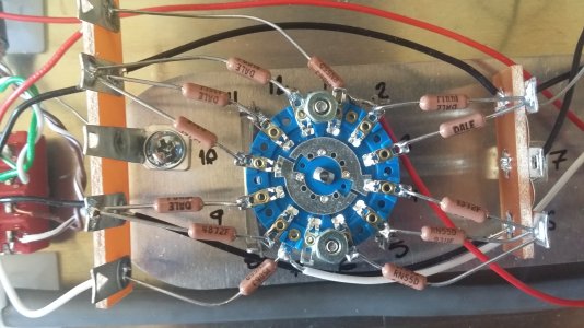

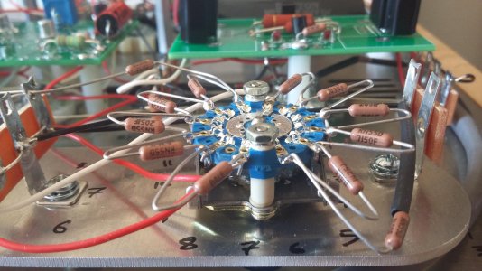

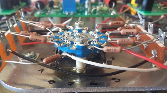

Can you possibly post photos of the attenuator build?  There's a lone resistor leaving terminals 1 and 5, you can check it's value even after the amp is built.  What value are you able to measure for this part?
With the fine switch turned all the way up and the coarse switch turned all the way up, what resistance values do you get for the two lower lugs on the coarse level control?
I wouldn't continue on to the voltage checks just yet, it would be frustrating for this to cause any additional problems down the road.

In those photos, your fine switch is not all the way up.  It's totally possible to not set the switch stops properly and end up with abnormalities like this, you'll need to double check that.

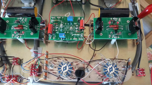

As an observation, I noticed that the LED's on the C4S boards are only lit up on the "A" side (as in the attached photo), is this normal?

Your 6C45's aren't drawing any current, as there is very likely a wiring mistake on the center PCB that is preventing proper operation.  Since both channels are having the same issue, it's likely that this mistake has been replicated which makes it a bit tougher to find.
You'll need to go over both the instructions for stuffing that center PC board, as well as the instructions for installing it to be sure that everything is where it should be.
