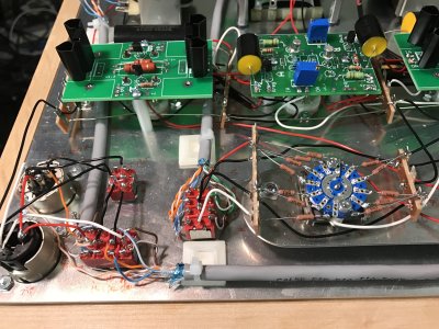

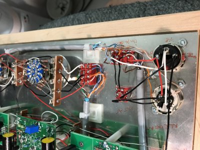

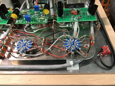

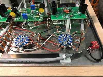

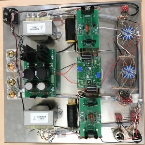

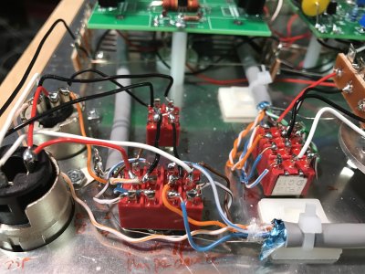

Building the Mainline for 3 days and it was failed on the resistance check.

You have a TON of terminals that are measuring as though they are grounded, but they aren't supposed to be.  Is there any way you can post some photos of your build?  I would say that you may have an issue of something that you think is reading "2 Ohms" actually being higher (22K or 2.2K), but you have other resistance readings that are in the thousands of Ohms.
