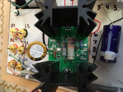

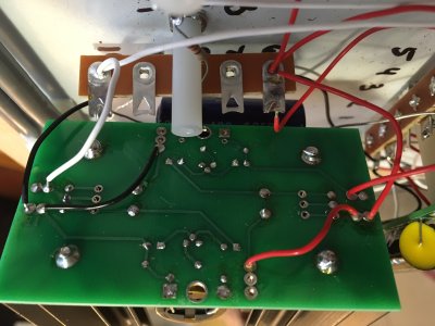

I've attached photos of one of the high current boards.  Please let me know if any other views might help!  Appreciate any advice I can get!  Thanks

Reply #7 on: March 27, 2017, 01:13:20 AM
Looks like you've got a 147K ohm resistor in the R1 Position on the A side.  Should be a 13 ohm part.  Page 45 in the manual.

Offline dheffer
    • Posts: 15
Reply #8 on: April 01, 2017, 04:21:51 AM
Thanks, thats a huge help!  I'll blame it on being partially color blind  ;D
I need to buy 2 new 147K parts, as the metal leads are clipped to close to work on the low voltage boards (the holes are much farther apart).
I'm having trouble finding exactly what I need - any advice on where to purchase?  I seem to find plenty of 1/2W metal film resistor, but not in the 147K variety.  Just can't seem to track down the right thing.  Would a 150K ohm 1/2W carbon film resistor be OK/close enough?
