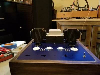

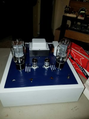

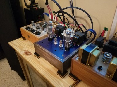

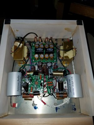

Just finished the Shunt Regulator and DC Filament install.  Initial power test worked, got filaments lit for all 4 tubes and all 8 LED's on.  Saw wisps of white smoke from around 13U so shut it down for tonight and I'll troubleshoot it tomorrow.  Since the fuse didn't blow I'll poke around and check the wiring in that area, solve it before going on to the voltage checks.
Some pics of the build.

Interested as to your thinking on using 10uF capacitors - isn't that quite a bit outside of PJ's design parameters? I'm using 1.5uF Jupiter Flats in that spot, which is at the low end of his range.  I went a little lower, so I could also try them in the Eros, which shipped with 1.5uF Solens.

The circuit is in the middle of a configuration change.  I changed the output transformer to a BH5 Ni which is 3K impedance.  I remember a formula from here of 2*L/R*R where L is the plate choke Henries and R is the impedance of the output, with a range on either side of the micro farad solution of half to double.  A standard Stereomour (stock) would be 2.5uF (supplied with a 3.3) so when I changed the outputs I put the final value I'm going for in place.  My setup will be BCP-15's at 40H and TFA-2004 pinstriped Sr at 3K so 80/9 (throwing out the zero's) for 8.8uF.  So I should be good for a range of 4 to 17 or so.
I think I got this right (if not someone please correct).

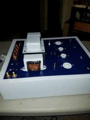

Latest update;  TFA2004's installed.  Tight fit.
Alonzo
    • Posts: 5911
Reply #13 on: January 07, 2017, 12:56:34 PM
The TFA-2004 transformers' coil axes are aligned with the power transformer, and thus likely to pick up a good deal of hum. If you rotate them 90 degrees, the hum will null out, and it won't be such a tight fit either. Two birds, one stone!
