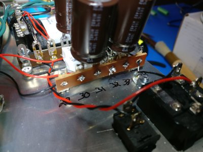

I'd be very interested in seeing a photo of your build in that area, being sure to include the IEC power entry module in the shot.
I would recommend not powering up this amp just yet.

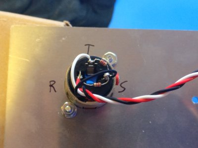

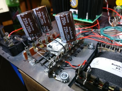

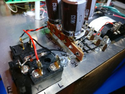

Interesting, I'll grab a photo quick.
But... I did insert the power cord to the IEC, into the wall socket, turned on the amplifier, measurements read right around 1k at 22 and 23. No tubes inserted, nothing else extra I can think of.
Pics inbound.
Offline TurbOSquiD77
    • Posts: 103
Reply #5 on: January 22, 2017, 01:23:27 PM
pics.
