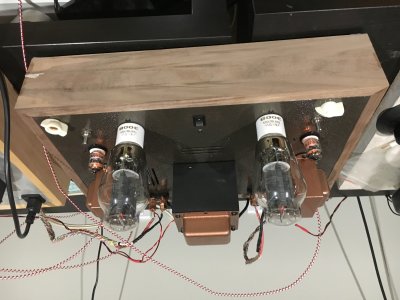

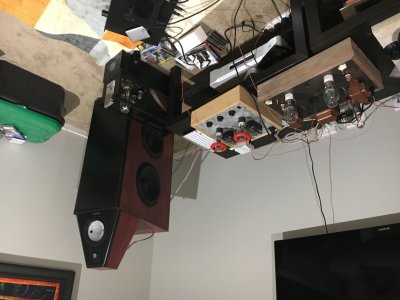

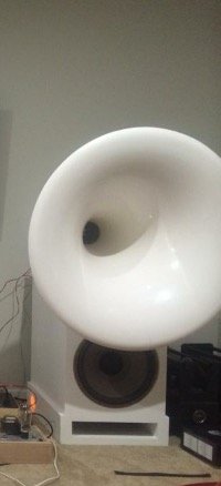

Offline slm
    • Posts: 17
Reply #3 on: February 23, 2017, 02:58:10 AM
Not the prettiest iteration...

    • Posts: 9664
Reply #6 on: February 23, 2017, 05:13:28 AM
Thanks for the lovely review! You have quite an impressive array of gear to be sure. I notice a couple of things in your images that prompt me to make a suggestion or two-
With horns that sensitive I would be inclined to try shielded interconnect cables everywhere. Even if you don't hear any noise you might find that the background gets more black with shielding. Do install the DC supply in the Kaiju first, that will make a big difference on the horns.
I see no acoustic treament in the images. Putting up some absorptive material at the first reflection points on the side walls and on the front wall of the room might take your system's imaging from stellar to cosmic.
Great review, and great work! Thanks for the pics!

The Kaiju was never really meant for the horns . They are heartbreakers and have been in and out of the main system for five or six  years - I get pissed off with their flaws and drag them to the workshop but then miss what they do well. The dynamics are to die for and on live material they are like being teleported to the venue ( think Nirvana live at reading ) but they are too coloured for long term enjoyment. They have been relegated to the family room and I usually fire them up when no one else is home and I want it LOUD .

Room treatment is, to me, a very important part of good sound. I'd give it a 33% weighting, 33% speakers, 33% other gear. I have seen more than one system at an audio show get best sound simply because the exhibitor was one of the few who bothered to treat the room. And I've done it myself.
Start by treating the first reflections. Put a rug in front of each speaker. Hang something acoustically absorbent on each side wall, where you would see a reflection of the speakers in a mirror from your listening position. Rugs, tapestries, ceiling tiles all help. Then do the same thing on the front wall, between the speakers. If you want to get serious, do the same with the ceiling. In general it's a good thing to treat the front wall all over, not just behind the speakers, because it will help to reduce some of the room resonances. Obviously WAF will be critical regarding this stuff, so consult the SO about what you use for treatments.
Once you have dealt with first reflections you can start to generally treat to room for smooth bass. The two tricks here are to 1) get some free room measurement software and measure the response while you move the speakers around a bit, looking for the smoothest response. Luckily, putting the speakers right up near the front wall can actually work quite well with some speakers. And 2) get some more absorptive material into the room. A soft chair or couch, drapes, wall to wall carpet, all will help. Last, and to me least important, you can put something like books shelves or open cabinets in the back of the room to break up the standing waves a bit.
