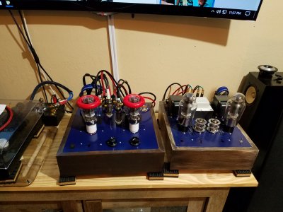

Searched the forum, didn't find a lot relevant to my situation except for Xavier's BeePre.  Has anyone added input transformers to the BeePree?  What was your outcome?  I'm looking to upgrade from a fully Smashed Smash and a Ingot knockoff, I shouldn't need two preamps but that's where I am for flexibility and sound.  Can a B7 Mexico input transformer BeePre sound good in a variety setting with multiple amps (45 and 2A3) into various dB speakers (86 dB to 101 dB)?  Id plan my setup without the attenuator or the balance circuit, Mike's B7 1:1 10K to 10K input transformers and the P&G pot, Goldpoint selector switch, 3 inputs and 3 outputs, all unbalanced.  Anyone foresee any problems?

Installation done.  Not at voltage checks yet, 2 LEDS not lit and some white smoke upon power up.  Will check it out soon as current trip is over.
Going to have to work on the length of the extensions to rotate the transformers since I put in such big caps.

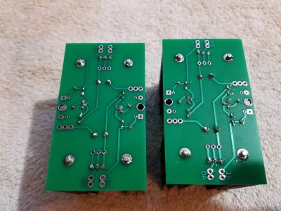

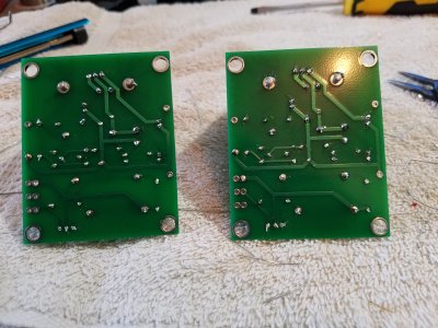

Boards out.

Touched up some solder joints and voltage checks passed.  Now to burn in till Monday, have to pad the input, way too much gain (also reverse the pot since I have it backwards).  Sounds good so far.
