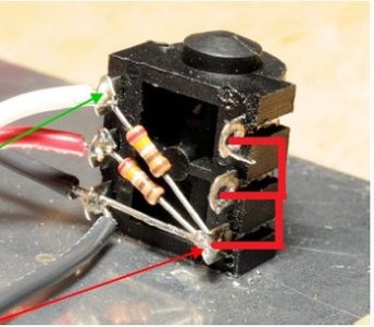

I know this question is beaten to death but please bear with me - I've been plugging in my headphones 30 secs after startup (I don't unplug when I turn the amp off) and I would ideally like to stop doing that and leave the headphones plugged in all the time. Every post on this topic links to a mod that is not longer available (dead link).
1. Should I just leave them plugged in?
2. If no, could someone please tell me about this mod to prevent DC surges at startup?
If it's any help, I use HD700s with the crack i.e. 150 Ohms impedance.

I believe that if you built the new version - Crack 1.1 - as I id recently, the mod is already incorporated in the regular build instructions (page 35).
However, if you have an older Crack kit you may need to get some instructions (essentially connecting the 3 lugs on the headphone jack that are on the side away from the 9-pin socket).
I leave my HD 650s plugged in all the time.

The mod was just to ground the unused tabs on the headphone jack.
I don't know why they removed that 'sticky' when the Crack 1.1 came out - likely still plenty of unbuilt, unmodified Crack 1.0's out there & this question has already popped up several times recently.

You guys are right, I've already done this. So should I be good? I mean, is it safe to leave my headphones plugged in since I have done the grounding?

I will throw in that I bought HD-800's new that are in the first couple hundred ever made, and I've never bothered unplugging them when powering up my Crack.  There just isn't anything to be concerned about here, and I removed the post about the modification since it's built into the current kit.
