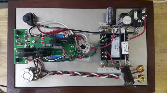

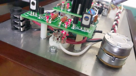

Hi there, now it has new issue. After normally running (with all LEDs light up) for few minutes:
 - There is a loud pop on the headphone and the left channel goes muted
 - One LED (at A3) doesn't light up.
 - Resistances: Terminals 7, 8, B3, B6 (which should be 2.9K) read */1
 - I'm using 220V AC input, the voltages are:
   1: 70
   2: 211
   3: 0
   4: 212
   5: 205
   6: 0
   7: 110
   8: 0
   9: 204
   10: 0
   OA: 210
   OB: 110
   G: 0
   B+: 205
I'm not sure if I need to replace that LED or resolder the connection points next. Any advice is greatly appreciated.
« Last Edit: April 19, 2017, 05:03:33 PM by Zniper »
    • Posts: 20295
Reply #4 on: April 19, 2017, 01:39:19 PM
The LED at A3 doesn't look to be all the way soldered to A3.  I would try reheating that joint first, then let us know what happens.
Offline Zniper
    • Posts: 4
Reply #5 on: April 20, 2017, 04:13:03 AM
Thanks much for the advice, I think that's correct as after reheating A3 and few other suspicious ones, the Crack normally works. I'm still keeping an eye on this though.
