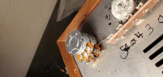

These?
    • Posts: 20260
Reply #31 on: November 01, 2021, 09:24:43 AM
Yeah, I would double check that the mounting hardware is properly installed.  If the metal tab of the TIP50 is allowed to contact the heatsink, you will get the issue you're having.

I checked the TIP50 assembly, took it apart and reassembled; it had been assembled correctly.  The insulator looks pretty beat up, probably from the wash, with some dents but looks intact (pic attached).
I went ahead and reflowed the TIP connections, then reflowed everything I could reasonably reach on the big board.
