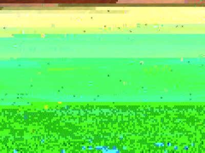

I haven't a clue but here is a couple of pictures of the back of the tweeter driver:
