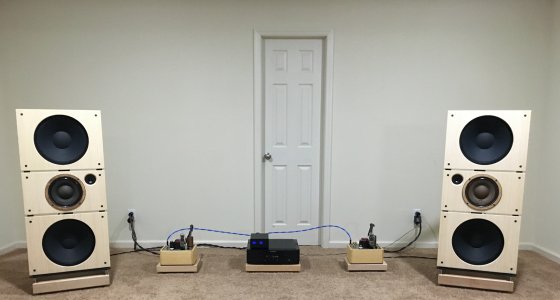

I’ll try to keep this as brief as possible.  Last year I moved my vintage ALTEC 756B/Jensen RP302 speaker drivers from 3-foot wide JE Labs style open baffles to Pure Audio Project (PAP) OBs.  I did this for two reasons.  First, the PAP OBs are half as wide as the JE Labs.  Second, the PAP OBs have built-in 15 inch woofers.  Two per side, so I no longer needed a separate powered sub-woofer.
I wasn’t sure if my Bottlehead Paramount 300Bs were powerful enough to drive the 15” woofers, plus the ALTEC/Jensen combo, so I used a Crown DriveCore 2 amp with built-in DSP crossover to power the woofers.  This worked very well and also let me dial in the level of the woofers using the Crown’s built-in level controls.

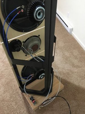

I recently got the idea to see what would happen if I tried powering the speakers full-range off the Paramounts.  In order to do this, I purchased a pair of 80hz 4 ohm 12db/octave low-pass filters from Parts Express.  The reason the filters are 4 ohms is because the two 8 ohm woofers per side are wired in parallel.
OK, so how did it sound? Not so great at first! The low bass seemed to be missing in action. Then I remembered reading that 12db/octave filters are 180 degrees out-of-phase. I assumed this was causing significant cancellation between the PAP woofers and ALTEC 756Bs.
The simple fix was to wire the woofers out-of-phase (reverse the +/- input connections) and that made all the difference! Now the low bass was back in business. See the attached photos for the system setup.  I sacrificed some bass response below 40hz but the overall sound is now more integrated (coherent).  The Paramounts were up to the challenge!

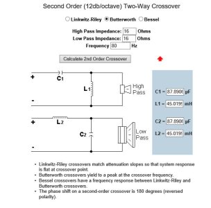

This might help you if you want to design it yourself as CB suggested: http://www.apicsllc.com/apics/Misc/filter2.html
Hi Michael:
I actually used a similar calculator earlier today to get the values I needed.  I just ran it again using the calculator in your link to confirm those values.  I grabbed a snapshot of the results (use the link below).
I'm only concerned with the low pass values and here's a problem - Inductor L2 is specified at 45.0199mH.  However, when I look for an inductor with that high a value, I don't find any at the usual sources (Parts Express, etc.).
Most are in the < 1mH - 10mH range.  I realize that 80hz is a very low crossover frequency but still expected to see higher inductor values available.  Maybe I'm missing something or not reading this right?
Gerry

High inductance like that is very heavy and large, especially with an air core. Here's a calculator:
https://www.diyaudioandvideo.com/Calculator/AirCoreInductorDesigner/
for instance, you can get 45mH at 0.85 ohms with 26 pounds (!) of 10-gauge wire, on a form 5" diameter, 2.5" long, and about 9" outer diameter. This is very close to the optimum (least expensive) design. The wire alone will weigh around 25 pounds and cost around $300 or more.
This is why active line-level crossovers and separate deep-bass power amps are so often used.

Well there goes that idea!  The inductor in the 4 ohm, pre-built low-pass filter from Parts Express is not that big so I ran the values through the calculator.  4 ohm woofers are 11.25mH, 8 ohm woofers are 22.5mH and 16 ohm woofers are 45mH (12dB/octave, Butterworth filter).  So, for every doubling of the woofer impedance, the inductor must be twice the size.
