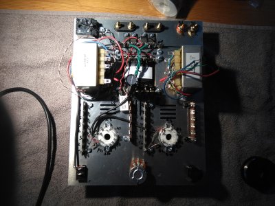

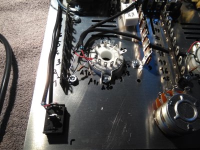

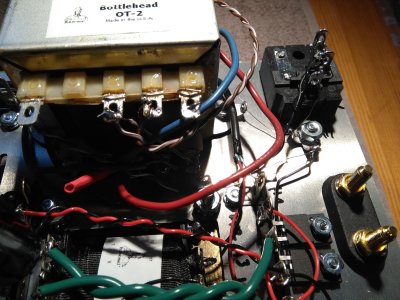

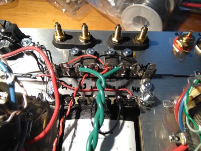

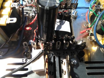

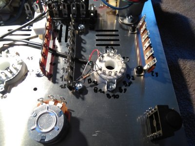

I took some pics of the wiring, if those help
OT wiring looks weird on the pics, but it is correct (for 8 ohm, i wired it for 4 ohm first and re-wired after i noticed)

edit: the drain wire from the shielded cable going to H1U is not soldered (it doesn't seem to say to solder it, just attach, i just checked again), but in later pictures it appears to be soldered.
Could that be the problem?
edit2: it wasn't

It looks like something strange is sticking up from A12.  What is that?  Something odd is also sticking up from B12.
H6L needs a bit more solder/heat.

that's just unclipped lead, i clipped them after the photos.
