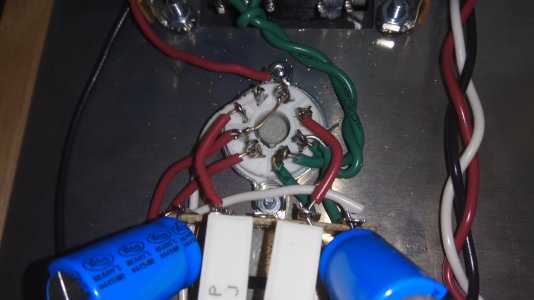

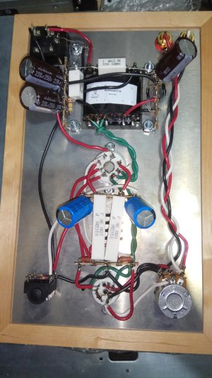

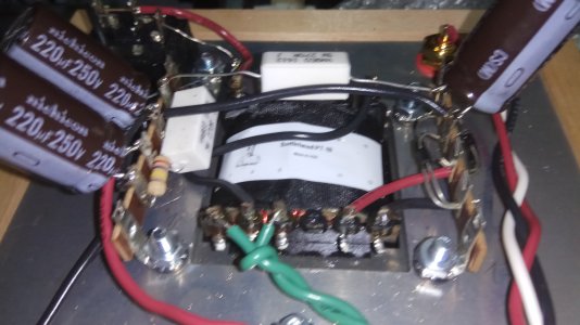

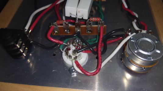

Yo guys, I've just finished building my first DIY headphone amp (with my father who can weld really well).
I've encountered a couple of problems in the voltage check(Page 49) -
I measured 5V instead 50V-100V on terminal 5
I measured 66V instead of 90V-115V on terminal 9
I measured 60KΩ-70KΩ at the Center of the black RCA instead of 90KΩ-115KΩ - not steady at all (jumps between 30KΩ up to 1, wouldn't get lower even when trying to change the measurement to 2M.)
Can someone please attach an image of the first check? I'm not sure I got it right (Page 47).

It does appear that you have mismounted at least the red jack—the shoulder of the shoulder washer appears to be on the underside of the chassis pointing up towards the nut. It needs to be above the chassis seated down in the hole to isolate the jack.
The wire that is supposed to go to A1 is going to A2.
