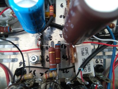

Reply #13 on: May 28, 2017, 07:34:54 AM

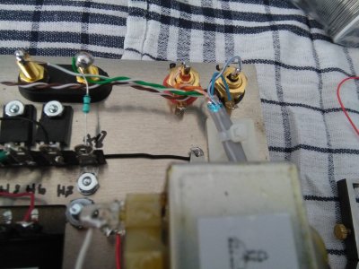

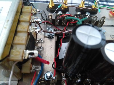

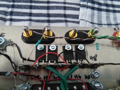

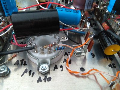

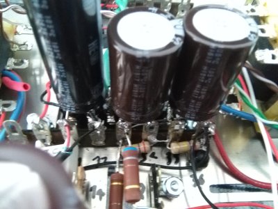

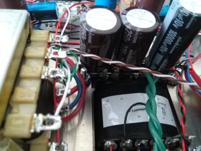

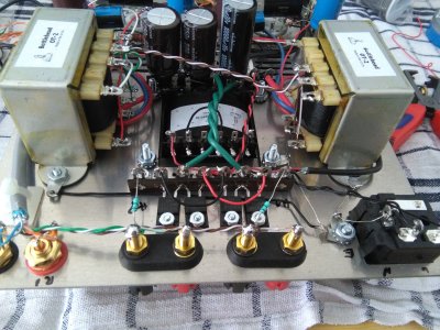

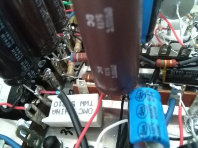

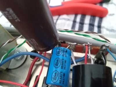

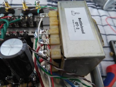

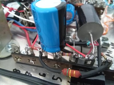

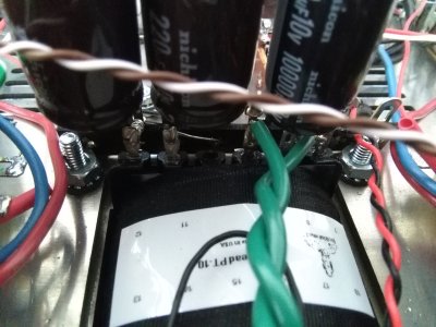

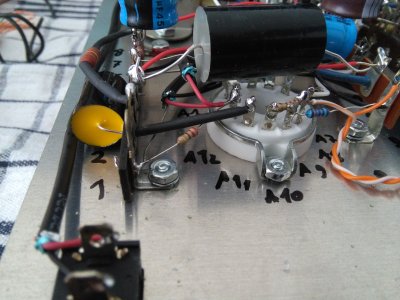

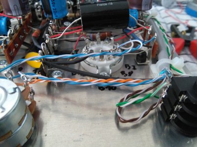

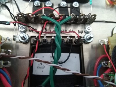

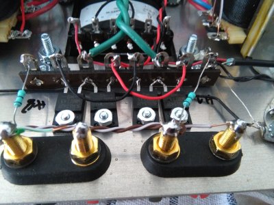

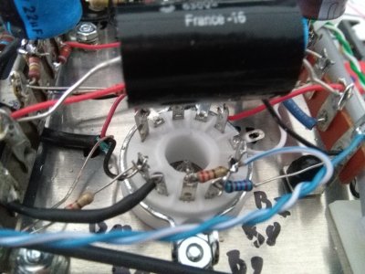

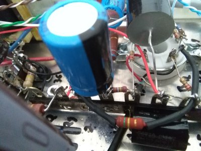

I took a bunch of pictures, not sure if it's too many to post

again i tried to chopstick around very very thoroughly, and not softly.
i could not produce the pop or any noise of any kind. the solder joints seem very solid, i ripped at the cables, tapped all joints and other parts, waggled everything around while using cheap headphones (pop is with speakers and phones) and could not get the sound to reproduce.
i'm seriously at a loss right now, i would try any farfetched idea you guys have.
