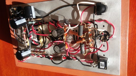

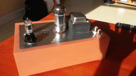

im about to pull the trigger on it just wanted to seek the advice of those those who are really familiar with it.. i have attached some pics of the crack mentioned. asking price is 350 euros... is it a good deal?   i was contemplating on getting  a darkvoice 336se .... any advise? thanks

That Crack is built the wrong way around, i.e. the chassis plate is upside down.

Reply #3 on: May 25, 2017, 04:18:38 AM
i noticed that too.. but will it affect the performance/sound negatively?
    • Posts: 9804
Reply #4 on: May 25, 2017, 04:22:57 AM
It will affect any attempt at service or modification. The assembly manual won't make sense, as the wiring will look different and the terminal numbering will be confusing. That will also make it difficult for us to offer assistance through the forum.
