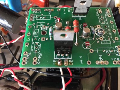

Sorry about the format for the voltages, but your list is correct. I have pictures of the board.  Are other area helpful?

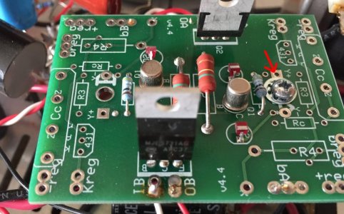

Perhaps it's a short between ground (the screw and star washer) and the Y+ pad?  (See arrow in attached photo.)
Reply #5 on: June 16, 2017, 07:34:59 AM
That screw goes into a nylon washer, and therefore is not connected to anything. Also it's on the A side of the board, and it's the B side that has the issue.

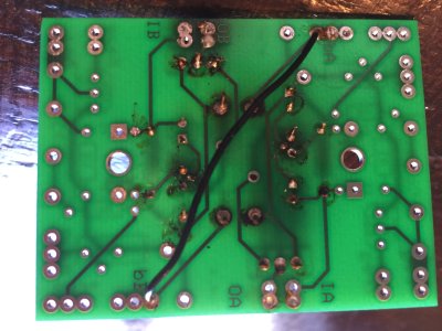

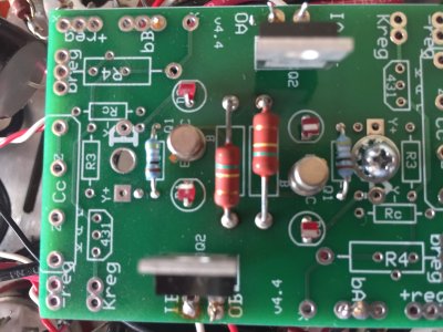

On the B side, the soldering of D2 looks sketchy. There is solder in a hole that isn't supposed to have anything attached to it (b/t the 499Ω resistor and Y+). Is that an errant blob, or a connection to something? Pictures of the underside would be helpful.

I flipped the board around a to b and the quiet channel switched sides.  I reflowed all the connections.  No difference.

I would reflow all those joints on the bottom of the PC board.
